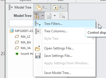

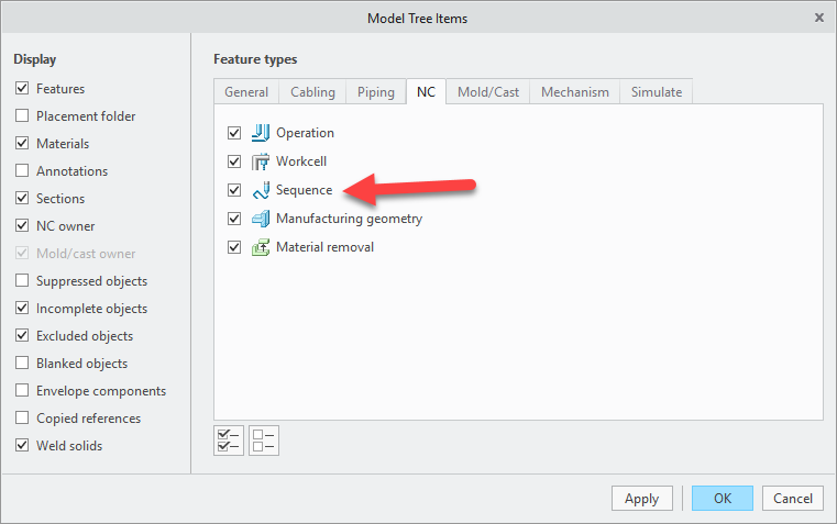

Perhaps the nc sequences are not activated in the Model Tree.
Select the option "Tree Filters'
Verify the option sequence is checked

I looked at that and it appears that everything is checked.  The odd thing is that I can actually play the Operation and all the tools are present in the tool manager, but there is no way to see or edit the sequences tied to it.  The programming is complete in Creo 2.0.
I would think that if I had a license related issue going on that nothing would work.
Matt

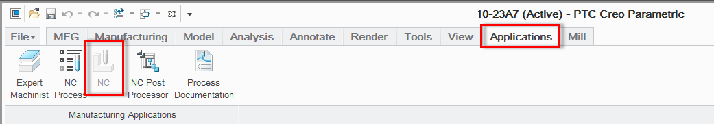

If this is license issue, please check your "Applications" then select "NC" type.
Have a good day!!

I've gone through the suggestions above and am pretty sure the install or licensing is hosed up.  I am now getting the message upon start up that says my License Server is not compatible.  If I OK through this, and refresh my license list, NC-Complete appears and I can check it.  However, I can exit from that screen and go back to it and the NC-Complete isn't checked anymore.

As per image license for manufacturing NC-Complete_SET is not obtained by application. Most possibly version of this license on server is not updated to work with Creo 4.0. Your IT can fix this problem by contacting PTC License management for new license file which will update on server.
