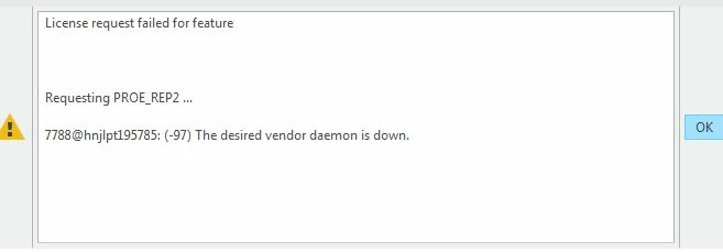

Dear all,
I have recieved latest license file for creo 4.0. I am able to run creo 2.0 & creo 3.0 using that license file.
But only at the time of creo 4.0 launch getting this error.

Dear Martin,
Please find below screenshot. I always ensure if flexnet services is started or stopped.
April 24, 2017
unfortunately checking the status of Flexlm Service 1 in Services dialog box is not the right way, how to check if license manager is running properly on your PC.
1.]
You have to check running processes ... can you see ptc_d.exe process running ?
What other processes can you see ... lm_admin.exe, lmgrd.exe ?
2.]
You have to check the contents of FLEXnet log file ... it can contain error messages...
Questions:
a.]
What FLEXnet version is installed on your PC ?
b.]
What "combination" do you use ?
lm_admin.exe + ptc_d.exe ???
-OR-
lmgrd.exe + ptc_d.exe ???
