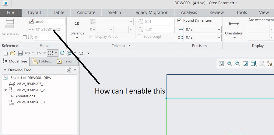

Hi Jim Barrett-Smith,
This is screen short of Creo 4.0 drawing. I need to change dimension value such that it automatically changes in part model as well.
Please explain which option do I need to change in config.pro and dtl file to enable this.
