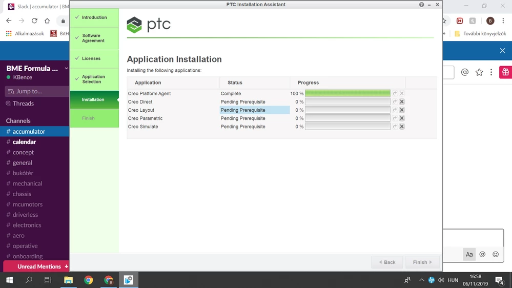

Some of the possible cause can be:
1. Less disk space
2. Firewall interference.
Try with above options, else:
Run creosvcs_64.exe from addon folder under install in installation media, once done run setup.exe to install application.

Can you attach your screenshot to the message?

Graphics card and settings may be incompatible.
What graphics card do you have and what software version?
What Windows OS are you using?
How much memory is in your computer?
