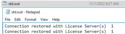

Check the contents of the std.out file in your working directory.  Does it show anything about losing a connection to the license server?

std.out contents below.  What does it all mean and how to remedy?
Connection restored with License Server(s) 1
Connection restored with License Server(s) 2
Connection restored with License Server(s) 3
Connection restored with License Server(s) 4
Connection restored with License Server(s) 5
Connection restored with License Server(s) 6
Connection restored with License Server(s) 7
Connection restored with License Server(s) 8
Connection restored with License Server(s) 9
Connection restored with License Server(s) 10
Connection restored with License Server(s) 11
Warning Licensing error: Excessive reconnection with License server(s), detected.
Connection restored with License Server(s) 12
Connection restored with License Server(s) 13
Connection restored with License Server(s) 14
Connection restored with License Server(s) 15

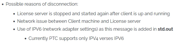

There is some kind of loss of communication between Creo and the license server.  Are you able to borrow a license, even for just 1 day at at time?
https://www.ptc.com/en/support/article/cs149103
