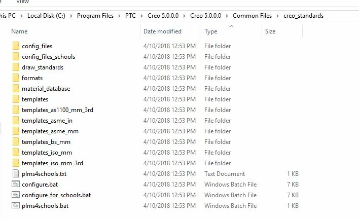

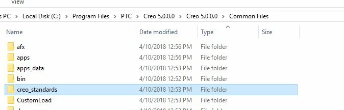

In CREO 3.0, I placed my config files (config.sup, config.pro, etc) in the <loadpoint>\common files \text folder.
When I loaded CREO 5.0 I found the folder as shown in the attached pics.
Does anyone know what these folders are for?
Do I place my config files in these folders or in the <loadpoint>\common files \text folder?
Thanks for your response.
    April 19, 2018

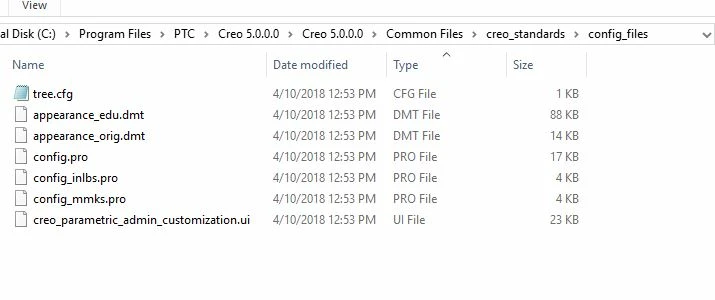

    It's folder with some preconfigured standards PTC started to include at least with Creo 1.0 and I think it's meant primarily for schools and universities to quickly configure their modeling/drawing standards to ANSI or ISO, since schools presumably don't create their own standards like most companies do.
    These folders have nothing to do with where you put your own files, they just hold preconfigured config.pro, .dtl and template files. You can safely ignore them and put your files as you always did.

    I noticed that there were files labeled "schools" or "edu", is this a student or schools version install?  It may differ from the commercial.

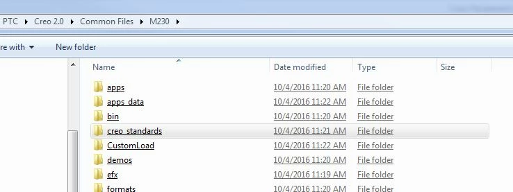

    Well, what do you know, there they are in my Creo 2 install too. Smiley Very Happy

    Thanks for all of your responses.
    I never noticed it before but these same folders are in my CREO 3.0 install.
    I was thinking that these folders were for schools and/or students, but I want to get some feedback first before I messed my installed up beyond repair.
    I will continue to place my config files where I always have.
