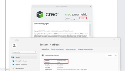

Dec 19, 2022 1:35 PM UTC
Yes, it runs fine on Windows 11.
