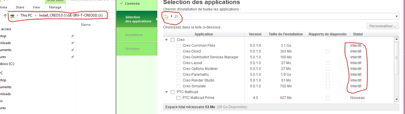

Hey everyone,
I tried to install creo 5.0 by changing the default path which is C:\Program Files\PTC.
I created a new map network drive called J: and shared it as admin but when I launch the Assistant of Installation PTC , it is impossible to change the default path. It indicated me BANNED for all applications such as Parametric , Simulate etc.
It seems so strange for me ...  anyone got the same issue ?
In attachment you'll see a screenchot of my issue.
Thank you in advance

Check the folder security settings.  Creo needs "Full Control".  (These are different from the share permissions.)
August 6, 2018
I think share permissions must be also "Full Control".
