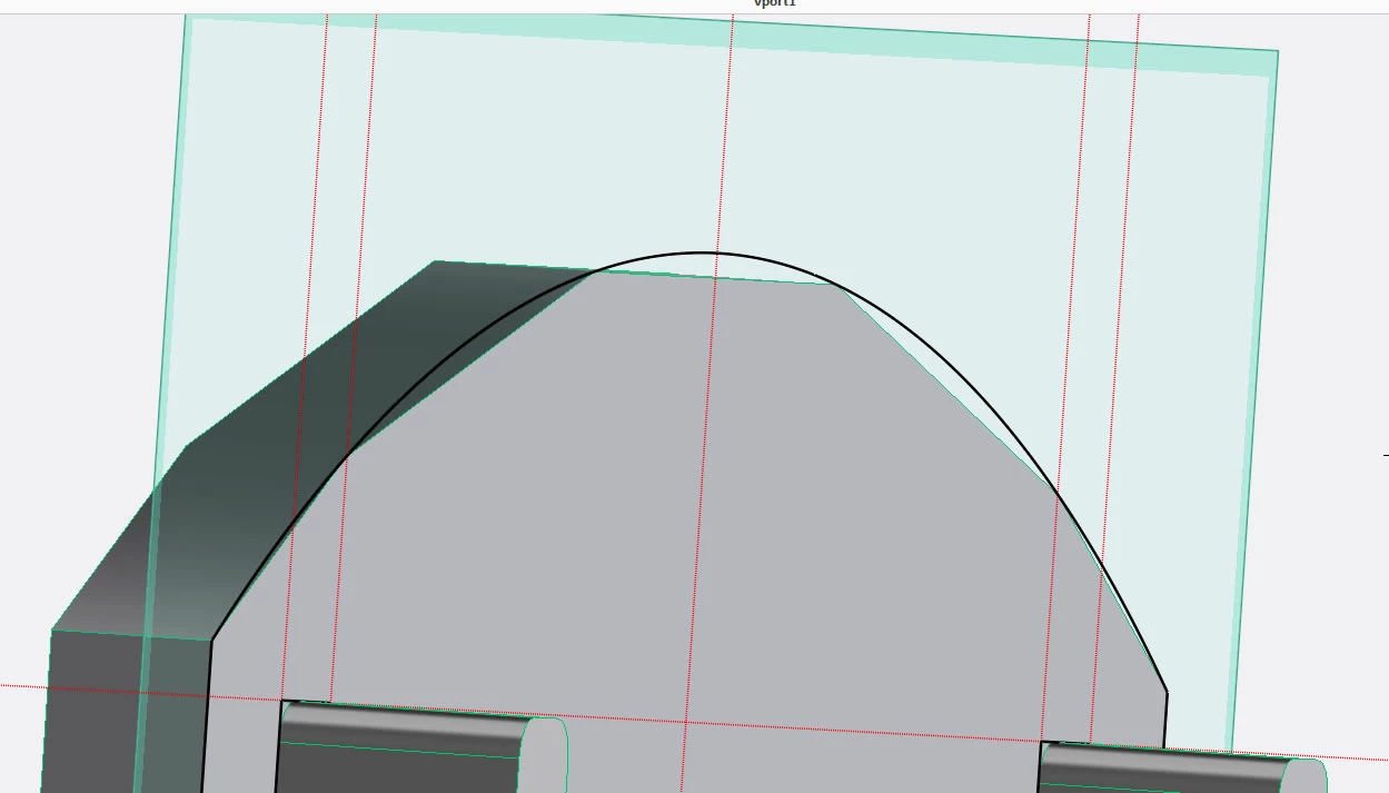

When you make a 2d circle and then pull to 3d the 3d is made up of short straight lines rather than following the 2d circle, is there a setting or a way to make the 3d pull follow the 2d circle, had a look through settings but can't fine anything that helps so i’m completely stuck, can anyone help me get unstuck? any help would be appreciated.
I have attached a screenshot which shows the straight line issue

Hello Dave,
select the part go to Part Properties -> Facets -> Select factor -> chose 3 or 4
Pay attention this change inkreases the file size.

That’s sorted it!!  Thank you very much
