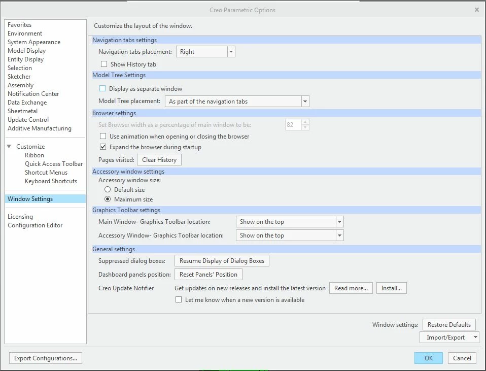

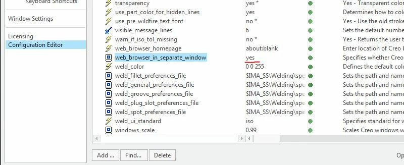

please provide more details ...
1.] What config.pro option do you use to show browser in a separate window
2.] What UI setting do you use ... attach picture
gfraulini17-PeridotAuthor
October 24, 2019
Here they are
Bye
October 24, 2019
2.] if I set WEB_BROWSER_IN_SEPARATE_WINDOW yes in config.pro and launch Creo 6.0.2.0 then standalone Creo browser window opens
