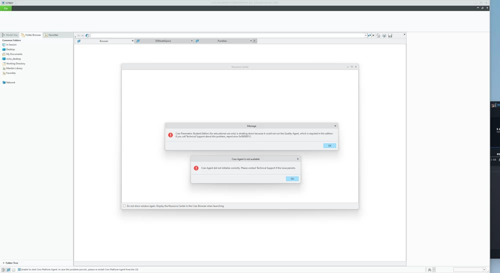

Creo 7 Agent did not initialize. Also getting could not run the quality agent error

Figured it out everyone I uninstalled the diagnostic tools from program filesx86 and then reinstalled them into the correct program files/ptc folder
