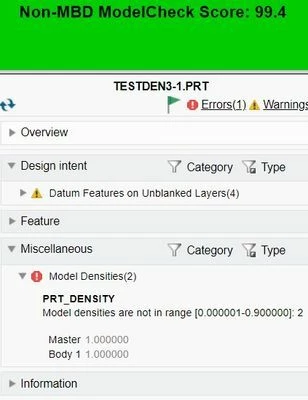

We ran across a similar issue with ModelCheck not throwing a error when PTC_SYSTEM_MTRL_PROPS material is assigned to a model so we implemented the following into our ModelCheck files since PTC_SYSTEM_MTRL_PROPS has a density of 1.
In the checks.mch file add the following line:
PRT_DENSITY YNEW E E E E E
In the constant.mcn file add the followings (Yes that is two P's in the second line):
DENSITY LOW 0.000001
DESITY_UPP 0.9
Since we just implemented it today, we are rewriting our code to the score will be a lot lower.
