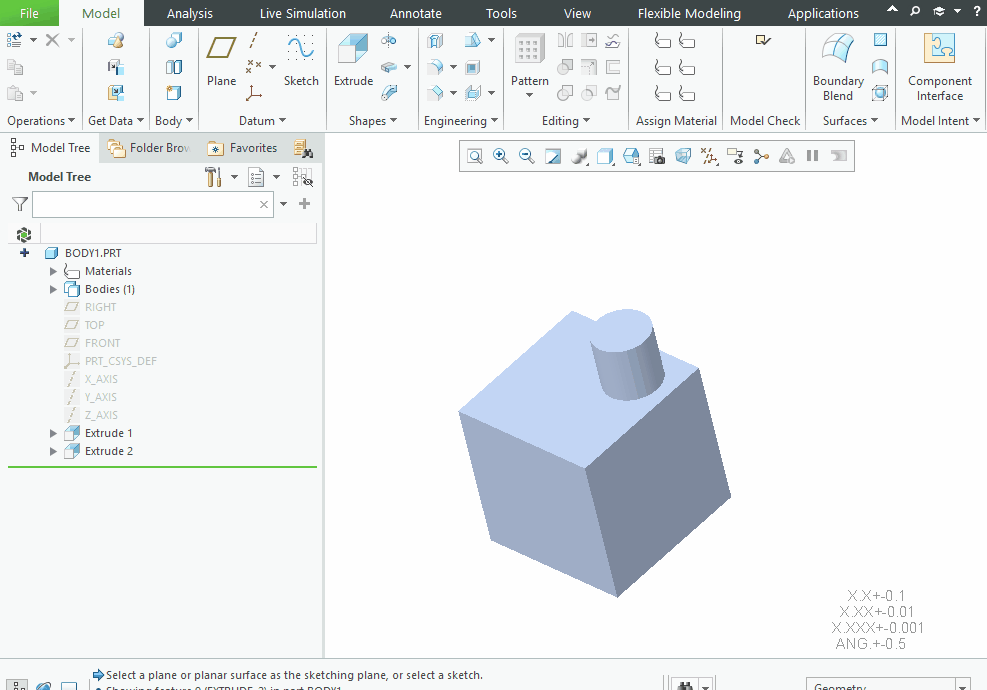

For anyone that stubbles upon this in the future, we have discovered a performance issue with Creo 7. We found it in 7.0.3 but I wouldn't be surprised if it is in the earlier releases.
See attached GIF. Everytime you do a save in a workspace with a large (1000+) objects Creo pauses after the save. I am still troubleshooting with PTC but my guess is that it is doing a sync for the new Creo server status in the background. This pause increases with the number of objects in session and we have seen it take as long as 30 sec after a save.
The resolution so far has been to set the config (default is 3)
dm_network_threads 6
I have a ticket open with PTC and I am working to get them to acknowledge that this is a performance issue that should be fixed.

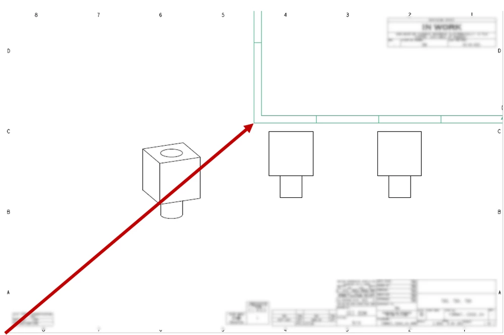

For anyone following along we found another error that is documented in CS23811 reproduceable in Creo 7.0.3. If a user performs a custom check in and checks "models and viewables" then the boarder shifts. This didn't happen in Creo 4. It is repeatable. PTC is working on it. If anyone knows how to disable client side publishing with the custom check in I would love to hear about it.
