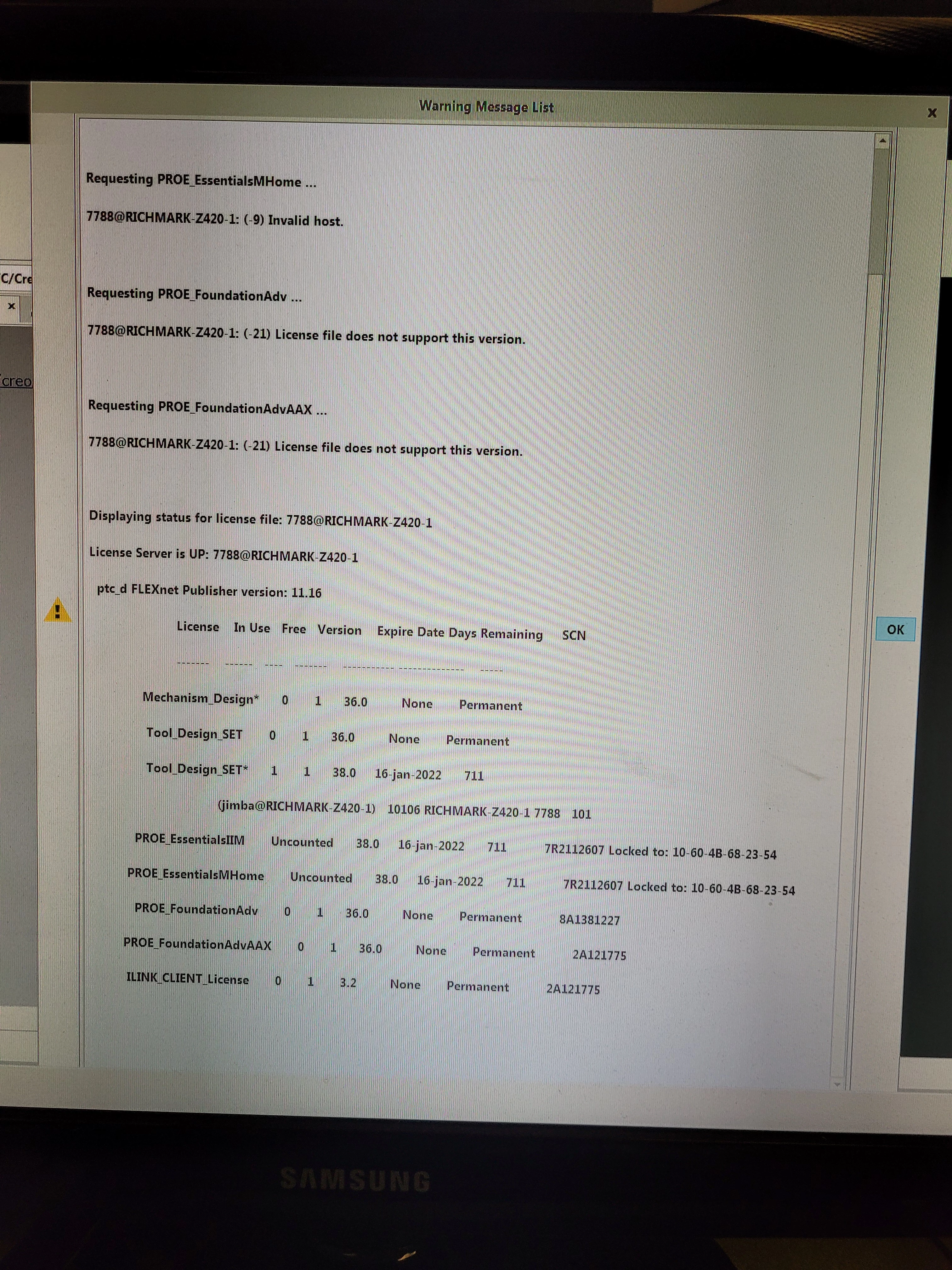

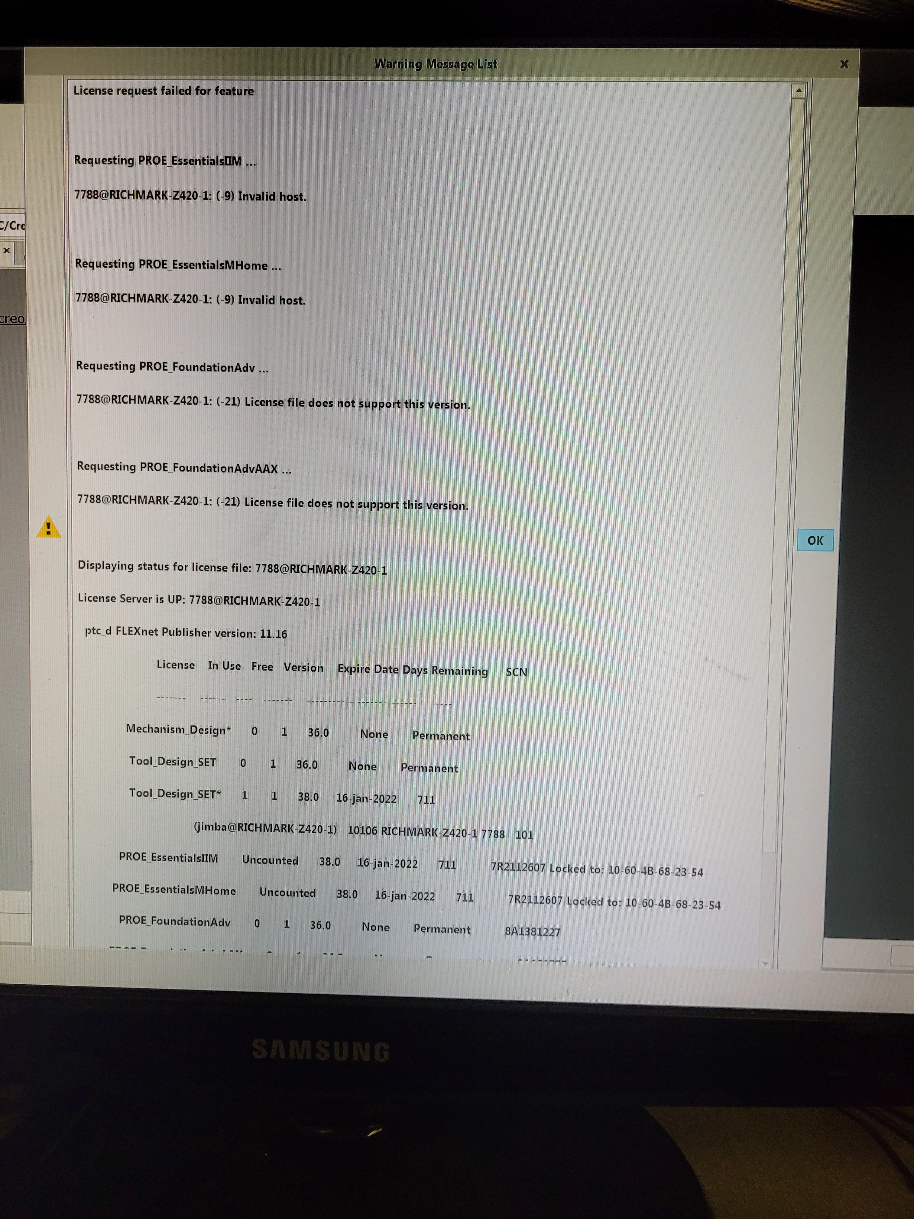

Creo 7 will not start
Upon starting Creo 7 on my computer I receive a warning message list that shows license request failures.  The license is on a coworkers computer and Creo 7 starts for him. Creo 5 still starts for me working off of the same license, but will not allow Creo 7 to start.  Attached is the message I get.
Feb 4, 2021 7:22 PM UTC
It looks like the 2 locked node licenses are Creo 7 (version 38.0) while the FoundationAdv is for Creo 5 (version 36.0).
Feb 4, 2021 7:58 PM UTC
Since his computer has the license and those 2 node licenses being locked to his computer.  Is that why I am unable to run Creo 7 on my computer?
Feb 4, 2021 8:28 PM UTC
Yes
The floating licenses are for Creo 5, which is why you can run it.
