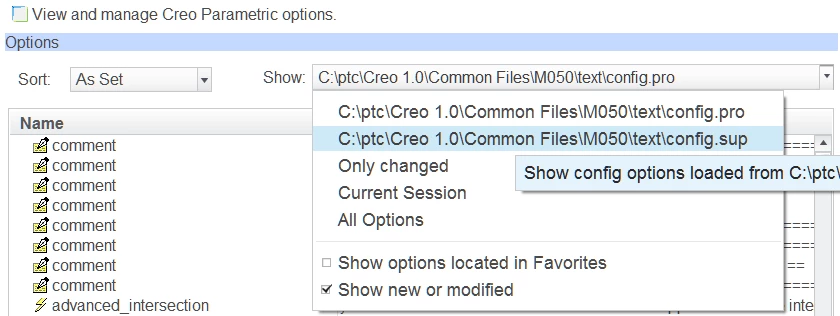

What I did:
Open the config editor
Select from the pull down the config.sup
[cid:image001.png@01CDBE52.A0E57380]

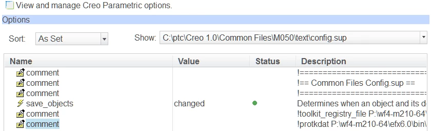

It now shows me only the config.sup. That is a big improvement!
[cid:image002.png@01CDBE52.A0E57380]

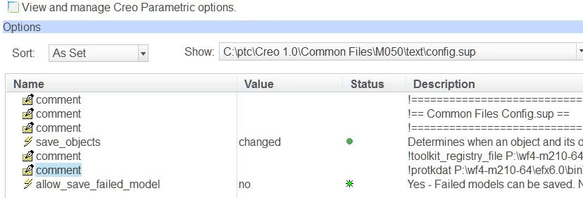

I next pick the Add... button and the Find... button search for something and added it to the config.
[cid:image003.png@01CDBE53.2EC29700]
So far, so good. Looking like I expect it to work.

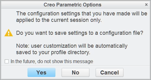

I pick OK, the only button that looks like it will save my edit for me.
I get this message:
[cid:image004.png@01CDBE53.801C1720]
I believe the correct answer is Yes

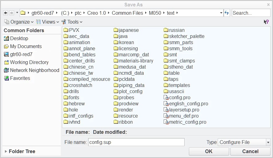

In the save dialog, I had to browse to the loadpoint. And then it would not show me the existing config.sup so I had to type the name in manually.

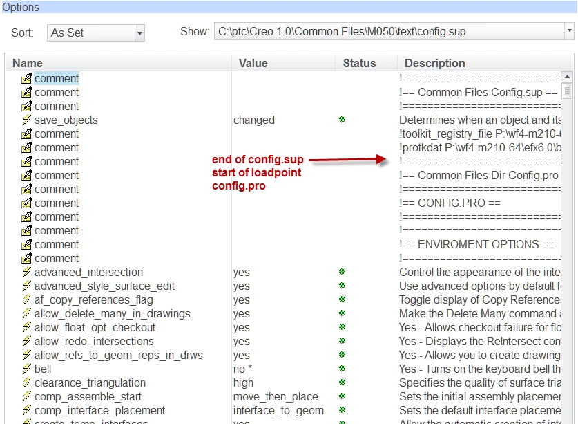

I then go back to the config editor to look at the config.sup again and I see this:
[cid:image005.png@01CDBE55.53DB7000]
My new option was at the end of the file.
