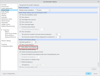

Hello Everyone!
We recently upgraded to Creo 6 and i have noticed different behavior regarding display of datum curve features.  I'm looking for the config option to enable the "show datum curve features" by default, anyone know the answer?

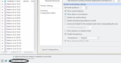

The option is SHADE_WITH CURVES
As you move your mouse over the options in the window of your screenshot, the option flashes in the message log.

Thanks Steve.  I actually already had this config option set and was racking my brain thinking there was something overriding.  I removed from the config and added back - all is working as expected now.  Thanks so much!
