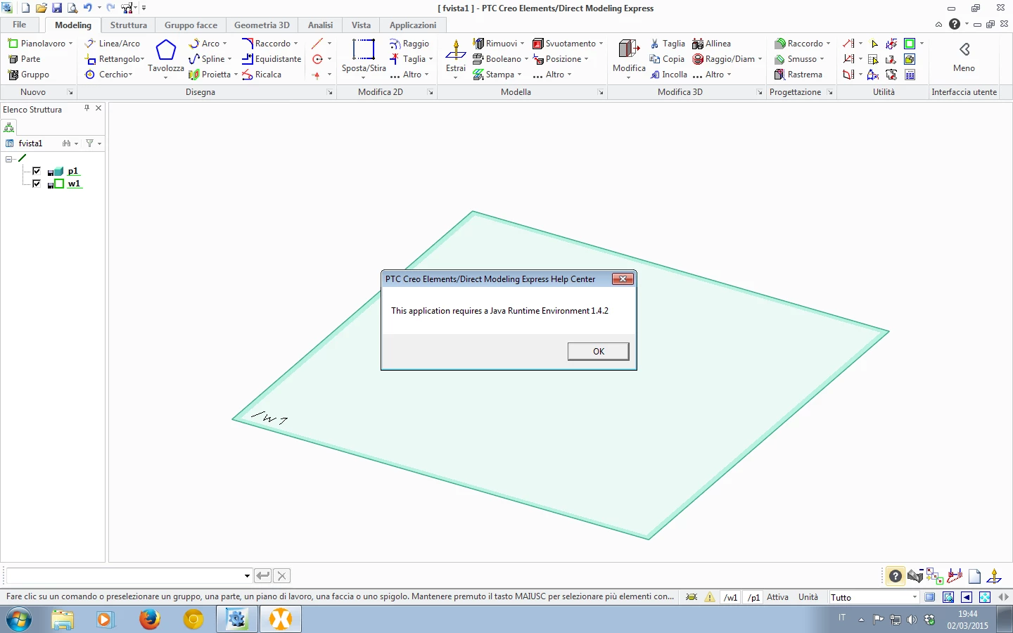

creo element 6 express Java problem
Hello. I hope not wrong forum. I have java fully functional version 1.8 I have this problem. Someone can help me? I also tried reinstalling Creo
May 2, 2015
I got this error when I had a 32-bit JRE installed - even though I also had a 64-bit SDK.
Installing a 64-bit JRE fixed my problem.
