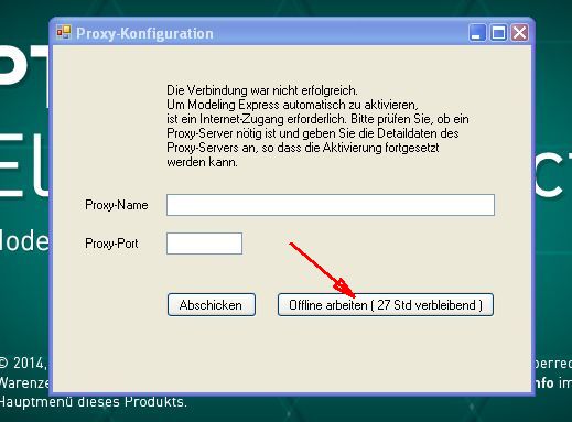

December 21, 2015
if you already have a manually created password and the program starts you will get this message.
Pressing on the button indicated.
The text is freely translated
Work Offline: remaining time in hours.
Attention, hold the remaining time in eye.
I do not know what will happen when the time runs out.
Perhaps the current model could not be saved.
Always nice to make a backup.
About Win 10 I can not say anything because I do not even use it.
