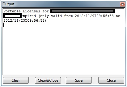

Hey everyone.
I have been having an issue ever since our previous CAD support person, notice I said previous , modified my system to use floating licenses.
Now everytime I start the application I get a message saying that the portable license has expired dated 11/23/2012.
Yes I have been clearing and closing the window since then because we don't know what he did.
Also, now I am unable to check out portable licenses using the licensing configuration client.
Now we aer stumped and his recent response was to re-image my laptop and reinstall the software.
Anyone have experience with this?
We have tried everything.
Thanx
Bill

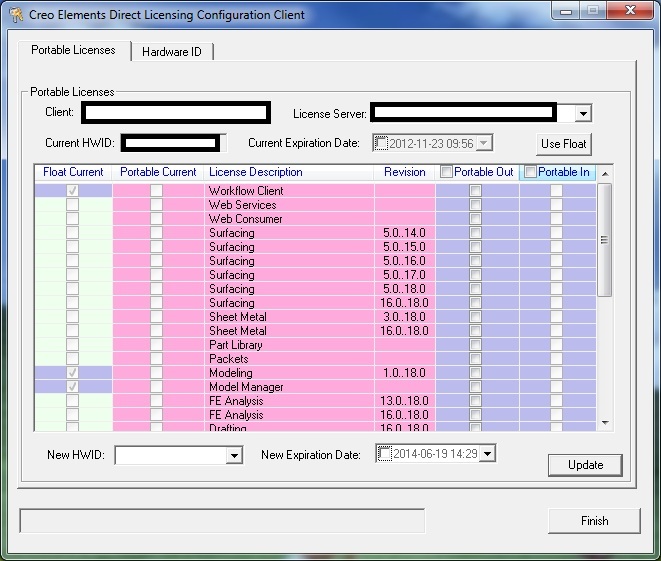

Jun 27, 2014 10:05 PM UTC
Hello Bill,
Did you try checking in just the ones that are checked as float current? I think there is also a way on the license server that you can do this too.
Jun 30, 2014 5:37 PM UTC
Yes we did and it did not work.
It seems that our previous CAD admin may have checked out the licenses while he was signed in on his account.
I had him log onto my PC under his account and it seemed to reset the licenses.
If a license is checked out is it reset when it expires when the user logs on the next time?
It seemed to be stuck in limbo causing me to be unable to check out any licenses.
Now that he has logged in and out it works.
Bill
Jul 14, 2014 10:34 PM UTC
From what I remember it is checked out to a specific user, so having that user login it should check it back in. You can either wait until is expires or I think you can force a check in any time.
