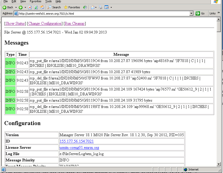

Creo Elements license server shows to much information
There was an update to the Creo Elements licenser server software that is causing many enties on the web page when setup to log all the file imports which we use to retieve files id they have been accidentally deleted by the user. When the new version of the license server is set as below the infos are appearing on the web page. If the message priority is not set to infos, the log will not have the information required to find the file name to restore the deleted file. Is there a way to Turn off the web page logging but still have the file information appear in the log file?
Message Priority INFO
Event Message Priority WARNING
PTC Case 11182848

Subject of this Thread is "license server" but should be "File Server".
Two different "variables" control the level of details:
- Message Priority
- Event Message Priority
I have written an article for the PTC Knowledge Base:
https://www.ptc.com/appserver/cs/view/solution.jsp?n=CS52933
If anything is unclear, let me know.

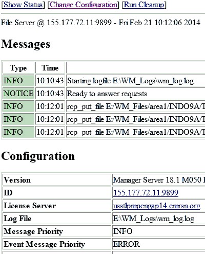

Feb 24, 2014 5:47 PM UTC
Hello Max see settings below and the messages that are appearing in the web page. Are these setting correct to keep the rcp put and get messages out of the web page?
