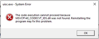

I was in Creo+ a couple of nights ago.
Last night I tried to login and I got this error
With Creo+ how do I reload the software?

I found this video:
https://www.youtube.com/watch?v=POOM8Qgz0gY
I reloaded my dll files as show and after I restarted, Croe+ said something about the update was successfully installed.

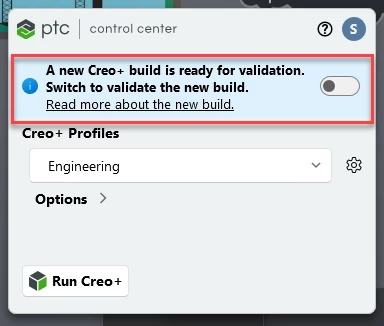

I tried mine and I was able to load creo fine.
I don't know how to re-load the software but maybe you can switch to the validation verison?

I cannot get to the control center.
It give that same error when I try to load the control center.

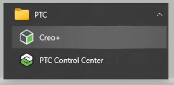

Dale_Rosema
November 15, 2024
In my start window, if I click on either I get the same message:
In the tool bar I don't have the Creo+ in the pop-up.

when I googled the dll file, someone posted it was a visual c++ runtime library. You can get them from microsoft.
https://learn.microsoft.com/en-us/cpp/windows/latest-supported-vc-redist?view=msvc-170

Hi all,
On vanilla windows OS, creo+ 12.1 is going to fail (CC/creo+ will fail to launch) due to missing -MS runtime - msvcp140_codecvt_ids.dll
We have identified this issue and are working to resolve this issue by including this dll.  The hope is to have this included in the production build of Creo+ 12.1.0.0 (available in December).
To resolve this today, we would ask that customers install – Microsoft VC++ 2022 latest redistributable package.  This can be downloaded from MS site - https://aka.ms/vs/17/release/vc_redist.x64.exe
