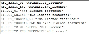

Feb 28, 2023 9:59 PM UTC
Compare the contents of this file on both machines:  Common Files\applications\simulate\text\licensing\mech\feature.dat
Mine looks like this:
