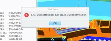

We have gone through a couple of build codes...m050 and m090.
We have experienced a couple of repeat offenders...first one is highlighted below.
[cid:image001.jpg@01CF3E00.E5CF6490]
This appears to be random...it has nothing to do with too little disk space or the users' permissions, it seems to be related to the actual models.

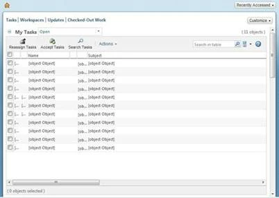

Just went live with WC 10.1 M040 and Creo 2 M090 yesterday.
First thing yesterday was our users has a problem of not seeing the values of an attribute in a search or a workspace. Through a separate IE browser it was fine. I am not sure if it was just Creo 2 M090 or that in combination with WC. What seemed to have fixed that is clearing the server side java cache. There were still a few users that didn't fix it for them. For those users we just had them do a refresh of the screen and it was fine.
[cid:image003.jpg@01CF3E00.E5CF6490]
Then we had a BIG, BIG, BIG problem with most of our users not being able to do certain actions. Mostly things like adding or removing files from a workspace. They would get a white-ish-gray screen with the spinning progress circle. But other actions provided the circle too. Most of my users lost almost the whole day. Again, I am not sure if it is because of Creo 2 M090 or both Creo and WC.
[cid:image004.jpg@01CF3E00.E5CF6490]
A call to PTC provided a temporary fix. In Internet Explorer go to Tools > Internet Options.
Under Browsing history select the Settings button.
Make sure Every time I visit the webpage is chosen.
That immediately fixed the spinning circle issue.
