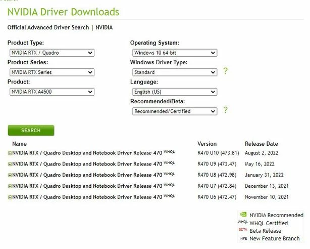

PTC raccomended driver 472.42 (update 18/03/2022) but this driver doesn't exist in Nvidia website or in the HP download center.
the oldest downloadable driver from NVIDIA website for A4500 is the 472.47 (see screen below)
the driver 472.98 (installed on workstation) is the driver versione certificate and reccomended from HP in their website, and it is the driver that internal ICT install by default on new workstation.
i'll try to contact PTC because to install a different diver version i need a certificate reason to submit to ICT department.
