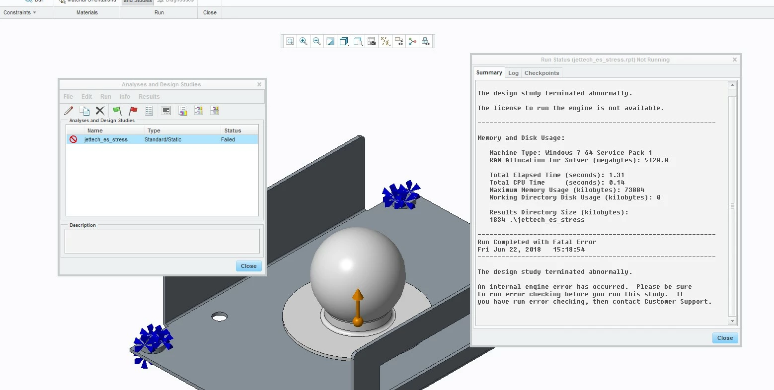

creo mechanica fails with license to run the engine is not available
  • June 25, 2018
  • 7 replies
  • 3402 views
Creo 4 mechanica, fails to run with an error "The license to run engine is not available" even though they have a license.mechanica_fail.jpg

    Do you have these lines in your license file?
    #MECSTRUCENG_STSIM        2     Pro/MECHANICA STRUCTURE ENGINE           Creo 4.0 Flt Lic perm
    #MECSTRUCUI_STSIM         2     Pro/MECHANICA STRUCTURE UI               Creo 4.0 Flt Lic perm
    #MECTHERMENG_TH           1     Pro/MECHANICA THERMAL ENGINE             Creo 4.0 Flt Lic perm
    #MECTHERMUI_TH            1     Pro/MECHANICA THERMAL UI                 Creo 4.0 Flt Lic perm

    We just re-did our licensing for Creo 4 and a lot of things changed, in particular the Simulate entries. The latest license file I got from PTC had the following lines (omitting the "Contract" column)
    #MECBASICENG_License     1    Creo Simulation Basic ENG (formerly Pro/  Creo 4.0 Flt Lic  29-oct-2018
    #MECBASICUI_License      1    Creo Simulation Basic UI (formerly Pro/M  Creo 4.0 Flt Lic  29-oct-2018
    This stuff is never fun.

    check the contents of feature.dat file. See attached document.
