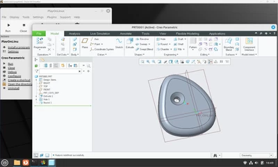

Luckily I was able to get Creo 10.0.5.0 running in Mint22 ( within a VM )
Steps to reproduce ( not a complete step-by-step tutorial)
  • Create a VM with VirtualBox
  • Install Mint 22 within the VM
  • Install "PlayOnLinux"
    • "Install a program"
    • "install non listed program"
    • "install a programm in a new virtual drive"
    • name it "creo 10" (e.g.)
    • choose 64bit installation
    • choose "setup.exe" in Creo installation folder
    • During Creo Installation, I skipped the license configuration ( I do not know, if it made a difference)
    • Surprisingly, the installation finished successfully
    • Choose "parametric.exe" within the PlayOnLinux dialogue to create a shortcut for Creo
  • Navigate to Your virtual "c-drive" and the creo installation folder within to edit "parametric.psf" ( change values for license and features )
  • Start Creo from "PlayOnLinux"
When Creo starts, there are a bunch of warnings (e.g. I could not connect Creo to my windchill server because of a self signed certificate), but it runs for now.
Unfortunately, I do not have some "spare hardware" to install Mint22 directly, yet. But in the VM Creo is still some sort of usable.
