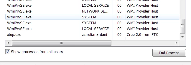

Hii
we just install Creo Parametric 2.0 M100 on Hp workstation Notebook, but we can`t open the application after setup finish. xtop.exe running on task manager but the application wont start with no error massage

    Hi Ruli,
    Are you still having an issue with getting Creo 2.0 to start?  Have you tried uninstalling completely and trying to re-install?  If so, please try setting the config option graphics to win32_gdi.
    This will force Creo to use the internal graphics card, instead of the machine's graphics card.  If Creo launches after that, then you may be using an unsupported graphics card or have the incorrect driver version.
