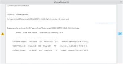

Creo Parametric 5.0.6.0 - License request failed for feature
Once i opened Creo Parametric 5.0.6.0. it showed the error below
please help

It's working now. Thank you
I try installing using personal Wi-Fi or hotspot from mobile. I faced the same issue when I installed the licensing using public Wi-Fi. Creo licensing is quite weird because it’ll setup the license environment based on the user Wi-Fi. Maybe it is student version.
I did as follow:
1. Reinstall
2. Delete all data
3. Again download by using personal internet
4. Again install.

please explain in detail how did you get the license.
Also open Command prompt windows, run ipconfig /all > ip.txt command and upload ip.txt file.
