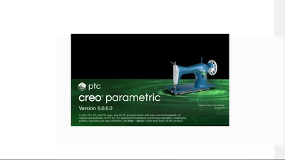

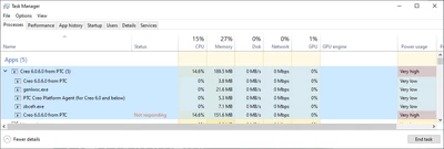

Hi All,
Did anyone noticed this issue of Creo parametric hangs on launch and error shows in Task manager as "Not responding".
Any suggestions?
August 3, 2023
If you have a Windchill server connected, try removing or renaming the Windchill cache directory.  By default this is %appdata%\PTC\ProENGINEER\Wildfire\.wf, but you may have it defined elsewhere.  Just note that this will clear any saved work in your workspace that has not yet been uploaded.  That's why I always recommend renaming rather than removing, so you can recover the data if needed.
