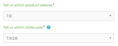

@unknown: how to open a case for a Creo version that is brandnew? I did not find a way to support you figuring out this issue. Now just read it in the newspaper tomorrow... 😉

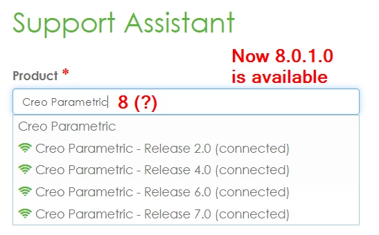

ROpitz27-BedrockAuthor
7-Bedrock
Aug 27, 2021 5:58 AM UTC
Hello TomU,
I am familiar opening Support Cases. Now, on August 26th, Version 8.0.1.0 is available to download and to use. But how can I open a support case for this version, if there is no option to select this brandnew version? See screenshot made today on August 27th regarding Version 8.0.1.0. I can open cases up to version 7.x but not for version 8.x. I would like to support ptc to figure out how to solve the problem. Thx.
