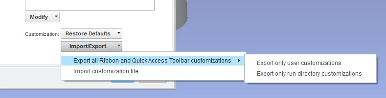

With "load_ui_customization_run_dir yes" set, the "export customization" in
Options>Customize Ribbon>Import/Export, there are two choices now:
Export "only user" and "only run dir"
Is the "run dir" the same as the load point?

I did notice that modding my QA toolbar this morning and exporting "only
user customizations" did save to my "start in" folder and the .ui file in my
.Settings folder was not modified. I think that is good news and what I
want.

I've not figured out a way to tell which ribbon customizations come from which file.
However, you can tell which files got loaded. Go to File, Help, System Information:
Scroll down to the section labled Configuration Information. It will show you what config files got loaded, including the .ui files.
I actually have a custom startup script specifically for editing the .ui file. It's saved me from pulling out what few hairs I have left.
