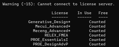

Is anyone have ever configure Creo Parametric FlexLM to work within 2 network using a NAT?
We have 2 network, so that the people on the second network can ping the FlexLM on the original network we configured the NAT to point the IP and Port 7788 of LM_Admin but the users on the NAT side cannot get licensing. as we run the ptc_status all license are shown "counted":

1.] Please publish a picture showing your network scheme.
2.] You can define port mapping on router. This creates tunnel between your networks.
3.] You can use VPN in second network to "create connection" to first network.
