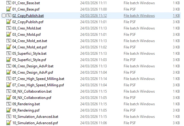

MarcoTosin
Apr 29, 2026 1:33 PM UTC
Create something like this on your bin directory
Launching parametric.bat you will see something like below image
Marco
KenFarley
Apr 29, 2026 1:57 PM UTC
Yeah, that’s similar to what I’ve got. There’s a DESC= line in the .psf that gives the text that will be shown in the menu for each option. It defaults to the file name, I suppose, but I’ve got things like “Creo Parametric (Default)”, “Creo with Manufacturing”, etc. They’re presented to the user in alphabetical order.
You guys have a lot of options. That’s one heck of a lot of .psf files. Must be fun if your licensing ever changes or PTC renames the license packages.
MarcoTosin
Apr 29, 2026 2:01 PM UTC
Actually, when we switched from perpetual licenses to subscription licenses, it took a while to recreate the list with the new license packages
Marco
