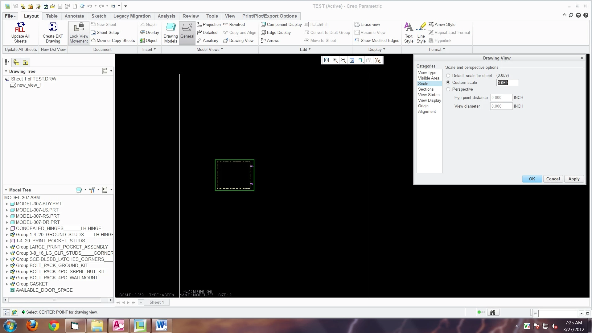

Creo Parametric M030, Unexpected Exit while editing Drawing View Properties
  • March 27, 2012
  • 3299 views
When creating a NEW drawing and editing the Drawing View Properties, Creo Parametric M030 unexpectedly exits. This happens when you click on the OK or APPLY buttons after you have edited the Custom Scale. It is also happening after you create a section view and click on the OK or APPLY buttons. This action is predictable in that it will happen every time.
Is anyone else experiencing this?
This is not happening on an identical machine. However, that machine had M020 installed before the M030 while this machine has only had M030 installed so identical may not be completely accurate.
Doug P.
Creo Parametric 1.0 M030
Dell Precision T5500
Intel Xeon E5603 @ 1.60GHz
1.60 GHz (2 Processors)
12GB Ram
Windows 7 Professional 64-bit Operating System
NVIDIA Quadro 4000
6-Contributor
March 27, 2012
I have corrected this issue by uninstalling and re-installing Creo Parametric M030. I hope I won’t have to schedule this in on a weekly basis. 😉
