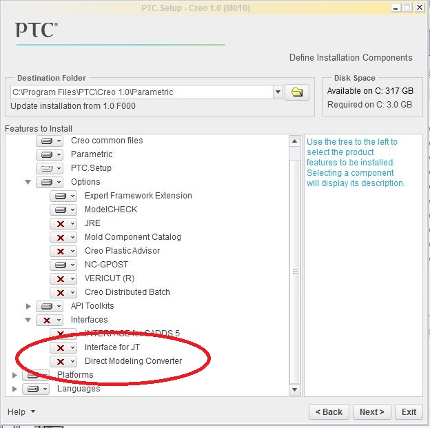

When I updated my maintenance, I was told that Creo Parametric could open Direct models ...directly.
On a default install, this is -not- the case. I was stuck on a mission critical stage and my VAR really pulled through!
I got an answer with an hour!
Turns out you need to specifically load the converters during install. And if you forgot, you have to do it from the DVD or the install download.

How many of you are your own admin... and how many of you are comfortable with the PTC install process? So far I missed adding Mechanism (although it is in the license! ...and the very capability I was counting on. (image courtesy of PTC support)

Opening .MI files is available in Creo 2.0. You just have to remember to enable it at the install oprocess.
