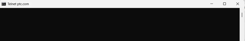

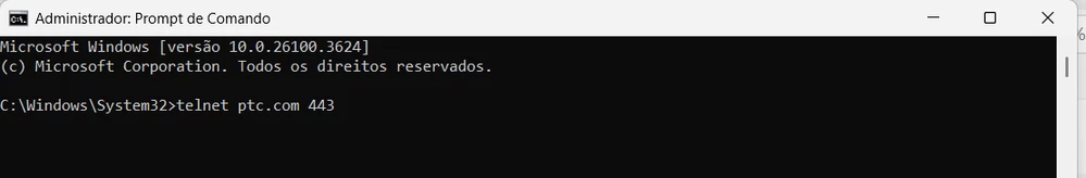

We are trying to use Creo performance advisor , but information from the machine is not arriving on the panel , we have already unblocked the Firewall and antivirus , we did a telnet test as shown in the following print , and I also put the site https://apps.ptc.com in the browser and the error Http/1.1 Service Unavailable appeared , would I need to do anything else for this CREO to appear on the panel ? I'm running Version 8.4Telnet.pngTelnet01.png

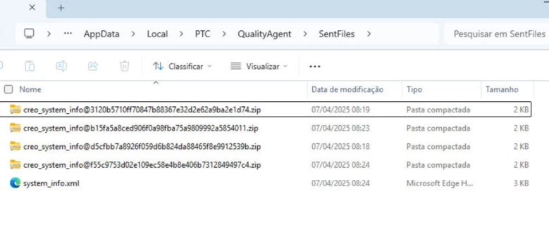

Yes it stopped in 2020 now I can't send anything anymore , I already released it in my Firewall to a full rule without blocking and removed the antivirus still nothing to send
MarcoTosin
April 7, 2025
From the image you attached, it appears that the zipper file containing the data to be sent to PTC was correctly created in the SentFiles folder and therefore should be present in your dashboard.

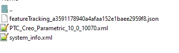

The first is that the zip file does not have all the necessary files in it, of which there should be at least three (see attached image).
If the zip file is complete and the data are not visible it could be a problem with the PTC queue, which receives the information and processes it with any recommendations, that received your data but did not upload it.
