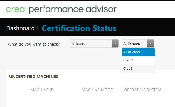

When will the Creo Performance Advisor support Creo 4? All of our machines are running Creo 4 m030 and the Certification Status screens shows no data. Only Creo Versions 2 and 3 are selectable from the version drop down box:
April 13, 2018
Please see article CS249344  where it is mentioned "compatibility gadgets (including Platform Summary), and more globally Hardware and Software Notifications, could not be completed". There is an product idea here if you want to vote for it.
