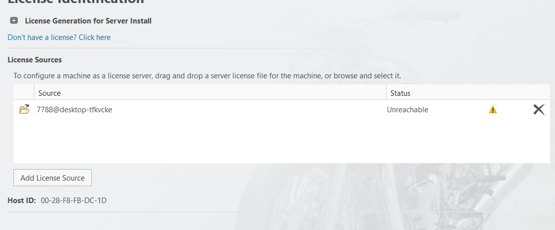

My license is perpetually voiding after 2 weeks of activation. I have done every fix for error 15 there is and reinstalled it multiple times. I feel frustrated with creo and would like help.
usually an access to license is blocked by firewall running on license server.
