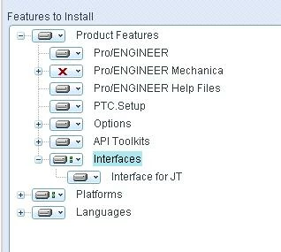

Aug 9, 2012 3:33 PM UTC
Hi all,
In addition to having a license you have to install 'JT Interface' ...
Take a look at the picture of the installation screen.
HIH
Feliks.
