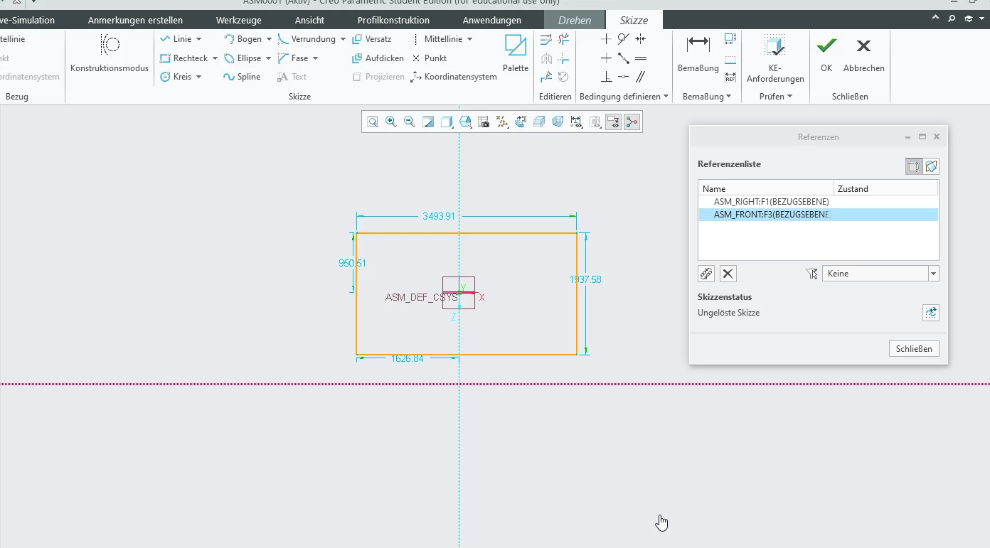

I installed Creo 9 student-Version in VM-Ware. The installation worked well and I am able to start Creo.
But when I create a new part and a new sketch, the references don't seem to match the planes. (see pictures).

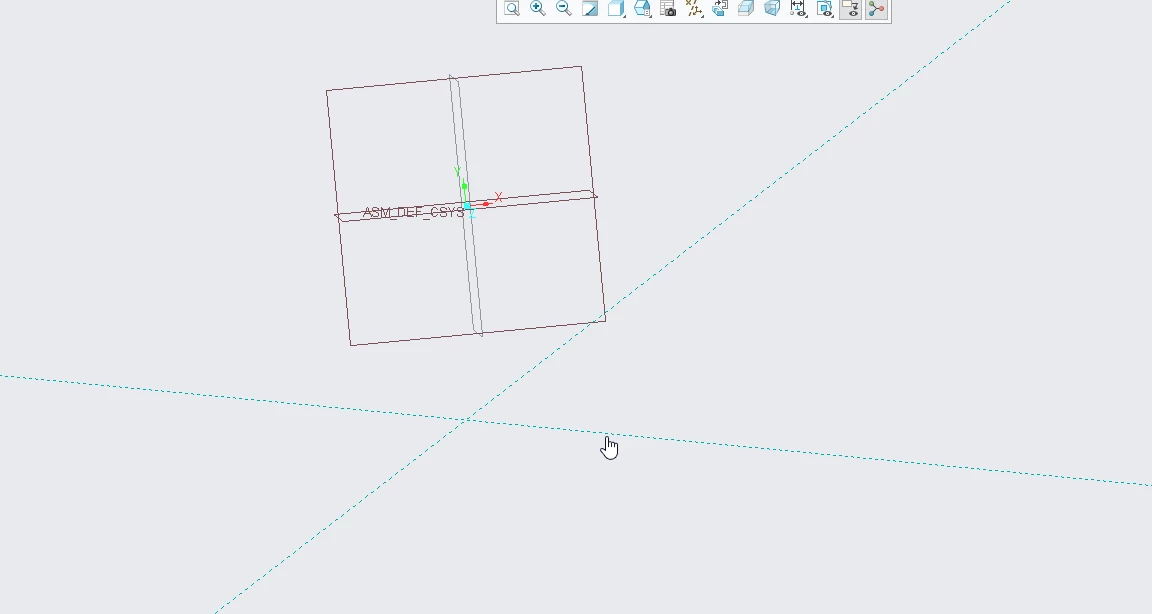

Also when I zoom out the references dont line up with the referenced plane anymore and move up/down...
What is wrong here ?

I seems to work now.
For other people having the same problem: Deactivate 3d acceleration in VMware-Settings (display).
