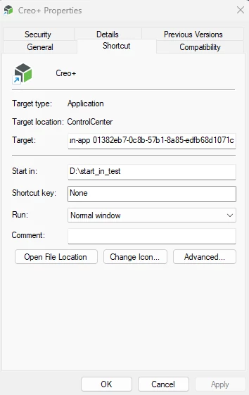

Changing the start in directory of the shortcut for Creo+ is not working. I am modifying the start in directory of the shortcut created on the desktop when installed. The desired path is visible in the shortcut properties but Creo+ is not starting in this directory when launched from the shortcut.

FYI there is an SPR assigned to this issue to be fixed. There is a workaround available that worked for me testing for a single user.
Article - CS416506 - Start-in directory set in desktop shortcut not working in Creo+ (ptc.com)
