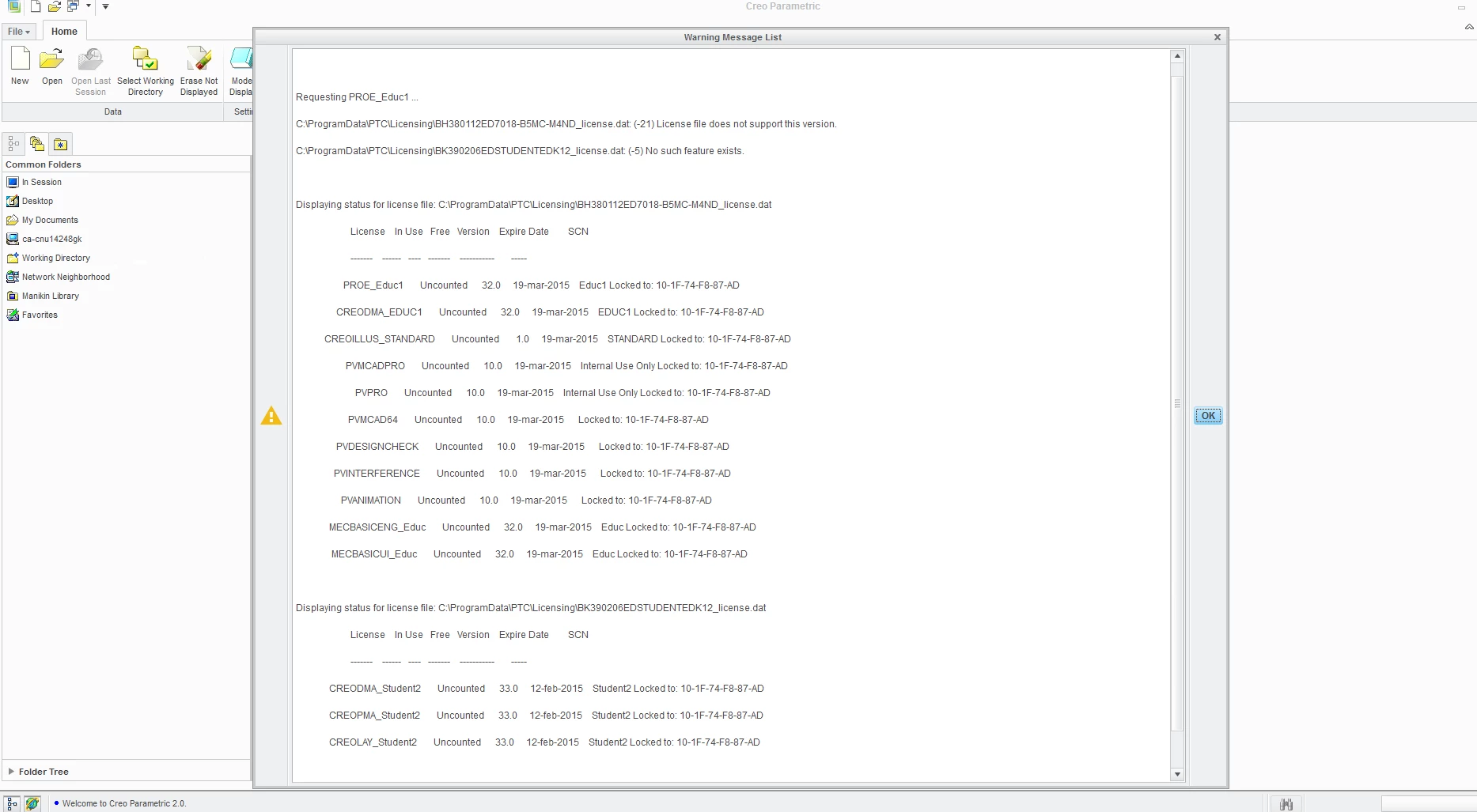

One of my students working on the RWDC was trying to install the version of Creo that we are using this year. He uninstalled the old version and when he used the universal code that we were given this summer he got an error Rick%27s+screen+creo+error.pngThat is a screen shot of what he got. ( it is attached as well.) His sister is on another team and she is having a similar problem. Any suggestions?

Ann,
look into your picture and focus on the line containing PROE_Educ1 ... the line contains number 32.0. This number tells you that you can run Creo Parametric 1.0. If you want to run Creo Parametric 2.0, you have to replace your license file with the new one containing number 33.0.

The first error line says so: Mismatch between software version and license.
