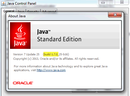

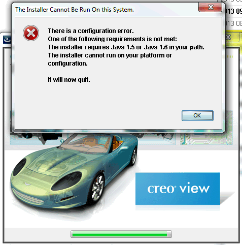

All,
Has anyone experience this issue when installing Creo View 2 M040 on
Windows 7 x64 with Java 7?
Work around so far is to uninstall Java 7, reinstall Java 6 (1.6), install
Creo View and then reinstall Java 7 which is being pushed out by our IT
department.

Lance -
Yep. Had the exact same issue this past Tuesday.
PIA
