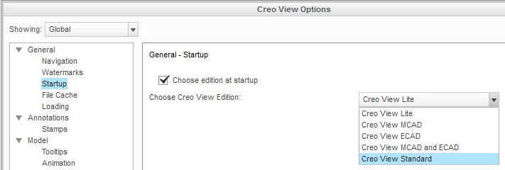

Now I can't find the commands for the silent install. I looked that the Creo View Installation Guide. But it only mentions about using the CreoView_32.exe or CreoView_64.exe.I assume that's forthe full version of Creo View. The version I am using hassetup.vbs.
Anybody know how to silent install Creo View Lite 2.0 or where it specifies the syntax?
Steve G
Jul 17, 2014 8:34 PM UTC
CreoView "Lite" is the same software as the licensed CreoView. Same installer, same install procedure, just not licensed.
