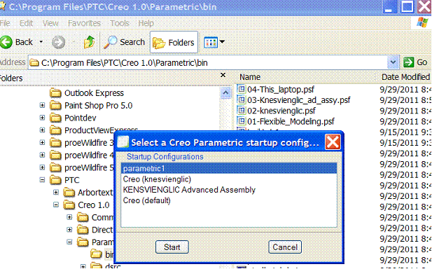

After I have installed and uninstalled Creo several times I have yet to
see one install, where the startup configuration dialog have the same
order of the various configured licenses.
In it latest incarnation I got two Creo (default) entries.
Do anybody know how to reorder these items. It do not seem to follow the
order set from within setup.exe.

Rename the psf files in C:\Program Files\PTC\Creo 1.0\Parametric\bin.
I name them with a prefix 01, 02 etc... so as to get Creo to read them
and present them in the order I want.

I found the answer to my own question.
The order is simply determined by sorting the .psf files in the bin-folder in ascending order. So I now start the names with 01, 02, etc. to get the order I want.
