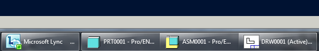

Is there a way (config option, other setting) to make the CREO 2/3 taskbar icons appear/behave the same as in WF4
WF4 icons tell more about the content of the window making it simpler to e.g. identify which window has the current favorite part ....
wf4.PNGWF4
creo2 icons.PNGcreo2
creo3.PNGcreo3

In Creo 2, the config.pro setting is:
show_object_type_in_taskbar yes
