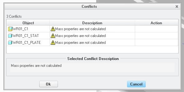

Many times when I save a model, regardless of whether it was regenerated
it seems, I get this error:
I have mass_properties_calculate set to automatic, so it should
calculate it, you know, automatically. Even regenerating immediately
after save and then saving again, I still get the error.
I'm seeing the little yellow dot at the bottom of the window and the
caution sign in the taskbar, but clicking on the dot shows nothing that
needs regenerated. I do have some mass props relations driving
parameters, but they are in the post regen section and therefore
shouldn't be tagged as not updated, right?
How can I either prevent the error or get the mass props calculation to
truly be automatic?
