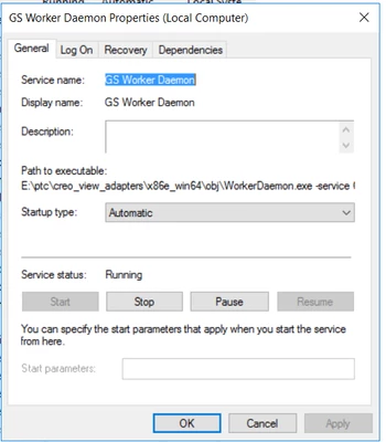

I configured them as Windows service (GSworkers).
In some machines, the service needs to be manually restarted after the machine restart.
Some machines, its get started automatically.

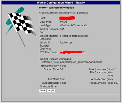

All machines' service settings are the same and the config is also the same in Windchill UI.

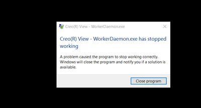

The below error is coming after the restart of the machine in those machines.
Help to fix it, so that the services get started automatically.
