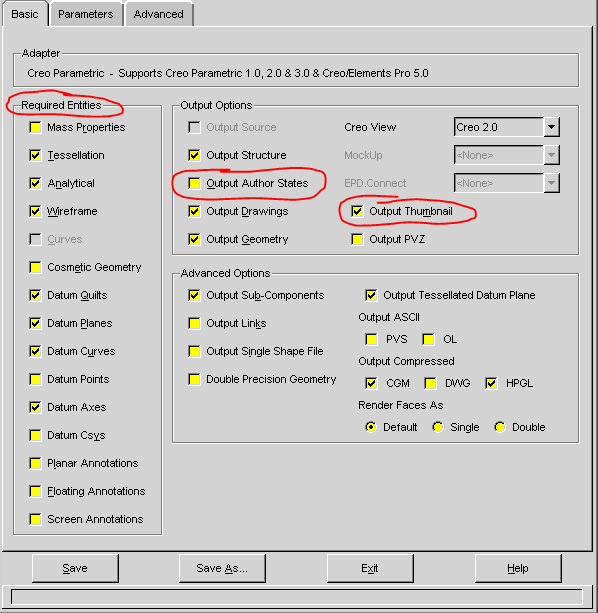

If you look at the trail file on the worker is Creo actually into the PDF generation step?
I've seen publishing hang (and fail) due to things missing that the recipe file says are required.  It might be worth unchecking some things just to see if it makes a difference.  (I'm not positive if these affect drawings, especially PDFs.)

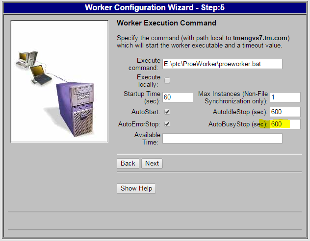

I added the AutoIdle and AutoBusy at 900.

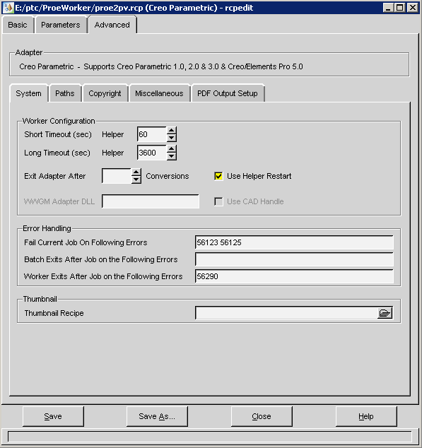

I set the  Advanced-System values to:
ShortServer: 900
ShortHelper:300
LongServer:2400
LongHelper: 4200
I just tried another drawing generation and it timeout after 13 minutes, but the MS log still says 600 seconds.
October 2, 2015
Are you talking about in the recipe editor?
