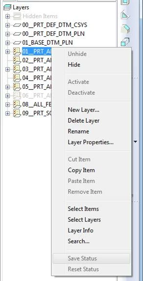

Curves and surfaces in parts and assemblies keep reappearing even though I've hidden them in Layer Tree. I have to unhide them and re-hide them to get them to disappear, but it seems to only have a temporary effect.
What's wierd is that I am saving the view status...
September 26, 2012
Have you saved the status of your layers after you have hidden them?
[cid:image001.png@01CD9BE8.850A38D0][cid:image002.jpg@01CD9BE8.850A38D0]
This has worked for me in the past.
